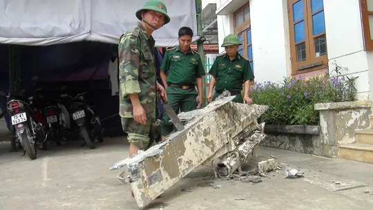

Help me verify name of this plane in this picture?
On plane have texts: 218L; 222L; 224L; REAR SIGNAL HORN; DO NOT RAINT; 21LVER PLATE WAGE; AIRPLANES…
Thank you very much!
This was recovered by fishermen 18 degrees 1 minute latitude North, 106 degrees 55 minutes longitude east of Hon La coast (Quang Trach district, 26 nautical miles northeast. I don't think it has yet been identified by the local government.
Here is another photo
Could be a part of Malaysian airlines MH370 that disappeared on 8 March 2014 while flying from Kuala Lumpur International Airport, Malaysia, to its destination, Beijing Capital International Airport in China
On reflection it is a Pylon and may have come from a Vietnam War era aircraft they may have operated in that area from US Carriers.
Doesnt look like one from an F4 though (could be wrong)
Ahem.. since I served with the USN for 20 years I can see something on that pylon that others may not see. I see the Bureau number..It is 15142?..so here . It is one of these three aircraft that was lost during the Vietnam war..
It was an F-4 Phantom. B model I think.
151421 (MSN 398) with VMFA-542 damaged by ground fire and crashed into sea off Da Nang AB, South Vietnam Jul 2, 1967.
Both crew KIA
151423 (MSN 402) with VMFA-323 crashed into sea off Da Nang AB, South Vietnam due to battle damage Oct 29, 1967
151425 (MSN 406) with VF-96 crashed into Gulf of Tonkin after bad launch off USS Coral Sea Apr 9, 1965
http://www.joebaugher.com/navy_serials/thirdseries19.html
Both crew KIA
