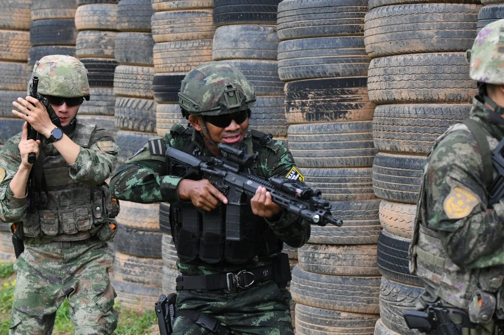

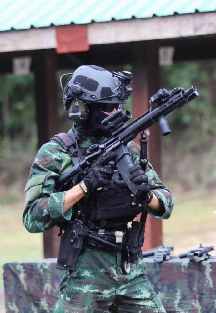

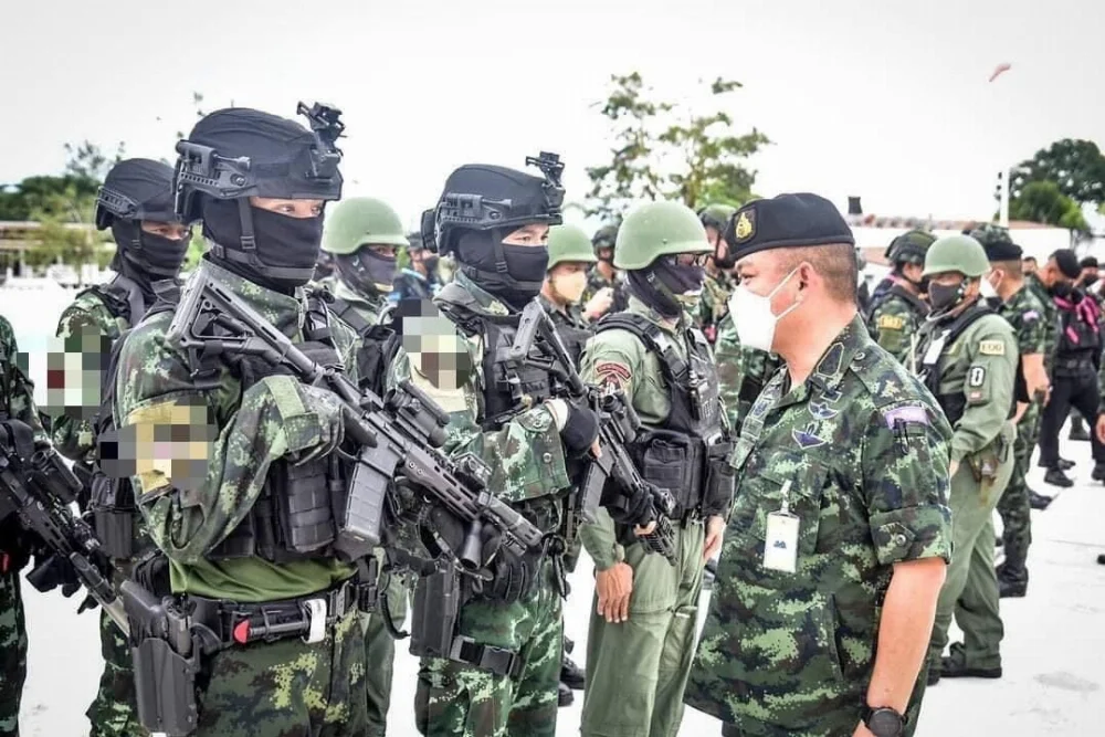

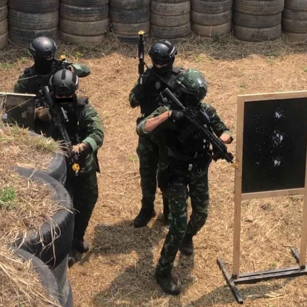

The Thais went from hand-me-downs to well equipped, very confident in their tools, looking very fit, and by their postures they're wanting to be there (well motivated). Other than a few bridged Aimpoint Comp M4's on a non monolithic rail upper and free float handguard, 10/10 would not underestimate these guys from doing the needful.
