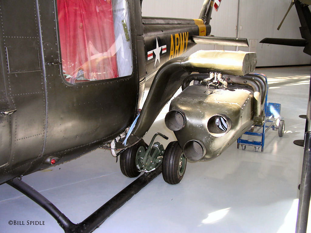

The “B” model had more horsepower and hardpoints for external stores, so naturally the guns got bigger and the ultimate helicopter super weapon, a 20mm gun cannibalized from an A-1 Skyraider was mounted under the belly on the centerline of the aircraft. The first shot blew out the chin bubbles.

Pic #17 is the B Model with the TOW system that was under evaluation for use on Cobras. I think there were three equipped like this. During the Easter invasion in 1972, they were loaded up and shipped to Pleiku where they stopped an armored invasion cold.
